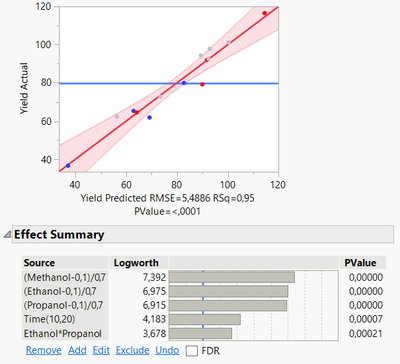

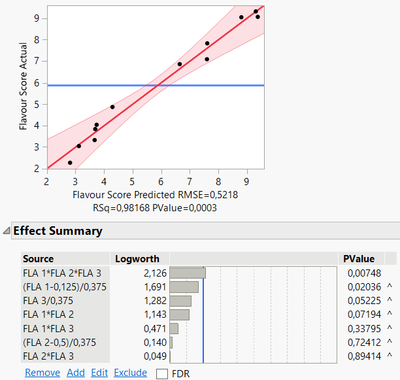

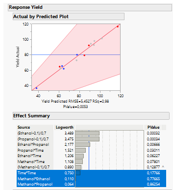

Did something in JMP 18 change in analysis of mixture experiment results. Below is shown that analysis results from exactly the same DOE data sets are different
1. DOE three component mixture
JMP 17 results
JMP 18 Results
2. DOE three mixture components + one process effect
JMP 17 results
JMP 18 results
In JMP 18 analysis above the model is different!
What has changed and why? Remark: despite of different plots & model graphs of JMP 17 - 18 prediction profilers are identical.

Find below feedback from JMP technical support, this is in agreement with the anwer of Vicotor above:
The difference you noted between JMP 17 and 18 was due to the Actual by Predicted plot not appropriately accounting for the "hidden" intercept in mixture models. To answer your last question in the community thread, the modified calculation of the confidence interval will persist into future versions.
