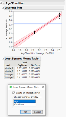

To do this, I will go into Fit Model and Construct a Model adding the Age effect, Condition effect, and the Age by Condition Interaction effect.  You can see how to do this in this video if you're unfamiliar.

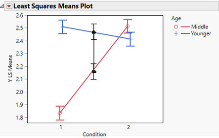

Our results in this case indicate that the the DID is statistically significant at the 0.05 alpha level.  Said practically, the degree to which Condition (2 versus 1) depends on the level of Age (Younger vs Middle) is statistically significant. Graphically this is perhaps more intuitive and can be visualized in the Fit Model output (in the Effect Leverage report):
If we schematically represent the average effect of Age 'eliminating' Condition, we can see that this effect is statistically significant if we approximate the error bars on this effect (as being roughly similar to the error bars drawn at each Condition-by-Age Level):
Non-overlapping confidence intervals give us evidence of an effect in the population in much the same way that a statistically significant p-value (that is, a p-value < the level of alpha, typically 0.05) gives us such evidence. This is the "confidence interval version" of a 2-sample t-test (see Bluman, Elementary Statistics (7th edition), 2015).
