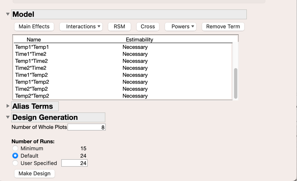

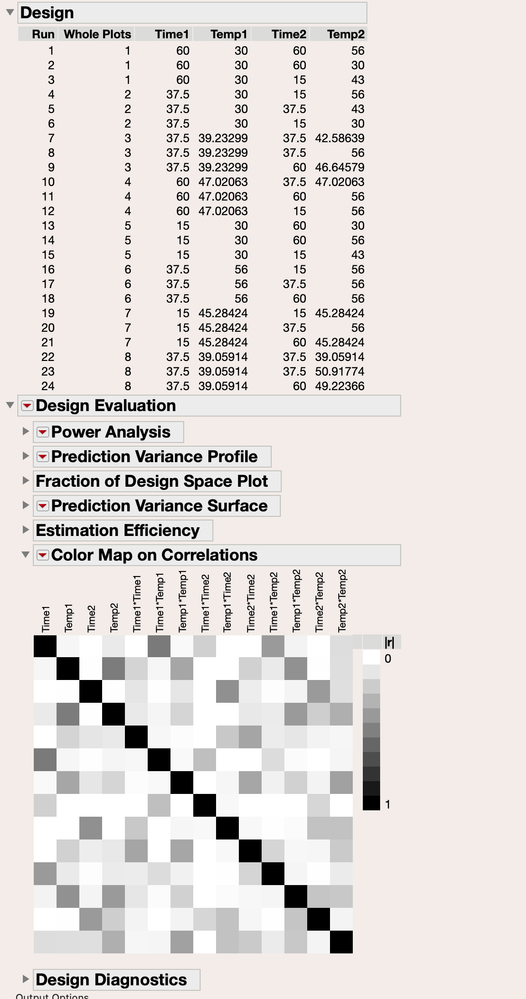

I did this in version 17 and it seems to work.
Choose "RSM" design (since you said you are doing optimization)
Resulting Design
Re: Determine equality constraints for related time/temperature variables in DOE
(a small addition/clarification) The above will generate a design where Temp2 is >= Temp1. If you need Temp > Temp1, then you'll need to determine by how much Temp2 must be higher than Temp1, then put the negative of that number in the Linear Constraints section (example for 1° minimum difference below).

OK, man was I overthinking this.  I had it in my head that I needed some way to actively associate the time stamp to the temp.  This works perfectly fine.  In my case, though, I think I need to set all four time/temp variables to 'hard?'
This experiment is pretty involved - the time/temp are processing parameters, but we're trying to choose levels of 22 different additives at multiple pH levels.  These are the equivalent of cookie recipes - everything gets mixed and put into an oven for a period of time at a given temp, and then the oven temp gets turned up for the second period of time.  I have a lot of experiments, but very few ovens.  I'm worried about blocking effects, but at the same time, mapping all of these components introduces it's own variance.
I'm thinking this means running as a d optimal design and planning for a follow up to augment the initial design, as running RSM pushes past my experimental budget.  Does this sound kosher?  Let me know if this is too much scope creep, and I'll repost as a new question!
