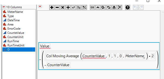

When I try to use any of the solutions here, I only get the first date (=0) and not the rest -I tried to sort in different ways to see if it is here I am doing something wrong
jthi
Re: Delta calculations
Your column names seem to be wrong, start by fixing those in the formula

Ah, I see the spelling error.

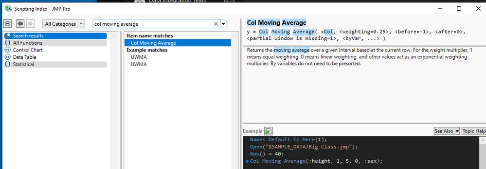

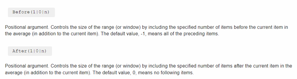

Is there a description of the col moving average function?
When I look in the support page the description dos not say anything about how many values it takes.
Col Moving Average
Returns the moving average over a given interval based at the current row. Missing values are ignored

I did provide link to the documentation in one of my posts: JSL Syntax Reference > JSL Functions, Operators, and Messages > Statistical Functions - Col Moving A... . In my opinion the documentation for Col Moving Average isn't very clear and usually I have to make some small tests to get it working properly (and remember how it works).
Other place to find some documentation (sometimes different...) is Scripting Index from JMP's help menu
