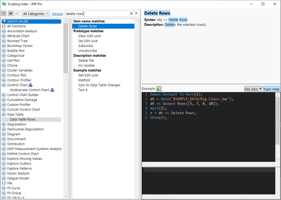

If you wish to just use << Delete Rows without any arguments, you have to select rows (like Jim did show). Other option is to collect your rows into a variable and use that (my preferred method as it skips "unnecessary" row selection but selection is more visual if you wish to debug)
Names Default To Here(1);
rows_to_delete = dt_new2 << get rows where(Contains(:Column 1, "Recipe"));
dt_new2 << delete rows(rows_to_delete);
rows_to_delete = dt_new2 << get rows where(Contains(:Column 1, "File"));
This behaviour is not documented in Scripting Index,
but it can be found from JSL Syntax Reference Data Table Messages (jmp.com) and Scripting Guide Delete Rows (jmp.com) (search Delete Rows from Script Editor and press Topic Help)
