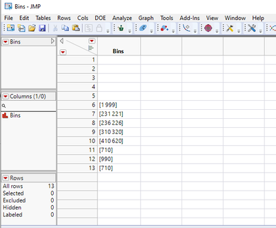

I'm trying to write a jsl code that removes numbers from a row if they are not present in a given list.
The list is in the table call "List values"

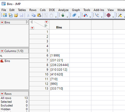

Bins values I want to modify:
For example: the jsl script should delete "444" from row 7 in the above table and likewise for other rows
Final result:

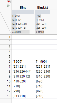

If it doesn't matter that the order is changed, using Associative Arrays is one option
Names Default To Here(1);
dt1 = Open("$DOWNLOADS/List values.jmp");
Column(dt1, "List") << Data Type("Numeric");
dt2 = Open("$DOWNLOADS/Bins.jmp");
aa_listvalues = Associative Array(Column(dt1, "List"));
dt2 << New Column("BinsList", Character, Nominal, << Set Each Value(
	If(!IsMissing(:Bins),
		r_aa = Associative Array(Parse(:Bins));
		r_aa << Intersect(aa_listvalues);
		If(N Items(r_aa) > 0,
			Substitute(Char((r_aa << get keys)), "}", "]", "{", "[", ",", " ");
Not sure why 410 wouldn't be removed on Row 10

Thank a lot, Jarmo!
Forget to delete 410
