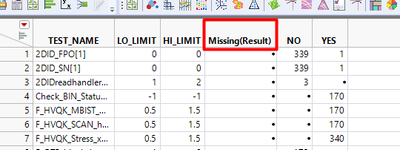

I have written a script for deleting the column "Missing(Result)" in the table
My problem is that sometimes I do not have the column "Missing(Result)" and I'm receiving an error at this moment.
Can you assist me with what I need to add to my script that will delete the column if it exists in my table.
And if it doesn't exist, just skip this request?
