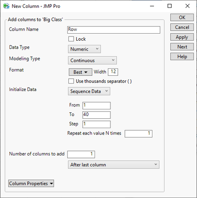

Toolbar/add-in/script with such a functionality. Or you can create initialized column after right clicking on the column header

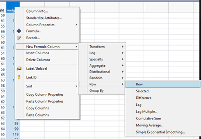

If formula is needed New Formula Column context menu should be able to do it

The approach via the  right click new formula column menu is nice - 4 "clicks" (or mouse movements without clicking).

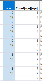

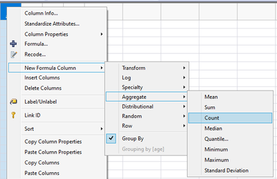

Re: Row cloumn
Seems like Character columns won't let you use Count which would do this when used with Group
