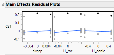

Re: Definitive Screening Design DOE for a large number of factors
You have some unusual observations for CE1 and CE4. The residuals are unusual. For example, here is the start of the plots for CE1:
These observations can have unusually high influence on the estimates of the model parameters and, therefore, the hypothesis tests that the estimates is not zero.
That's a great finding Mark! I never pay too much attention to the Main Effects Residual Plots, now I know how to use them.
I've validated my simulation data and all those outliers seem to be real, so I can't really remove them from my DOE.
What's the sensible next step that you recommend?
Is there a more reliable screening approach that you can share with me?
Thanks.

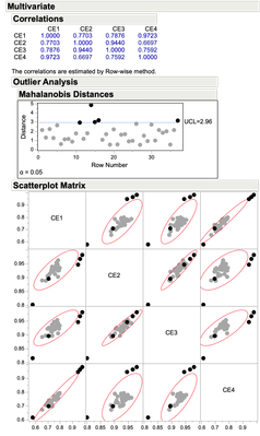

statman
Much as Mark found, there are some unusual data points.  These may be due to noise rather than treatment effects.
hanyu119
Level III
The Multivariate is a great method to detect outliers. Thanks for sharing!
I've validated my data with the simulation and all the data is real.
Row 15 & Row 16: since l1_tilt y is the most dominant factor in the system, when l1_tilt_y is 0, which is the case for Row 15 & Row 16, the coupling efficiency of CE1 and CE4 becomes very high compared to the other runs. That's why JMP thinks they're outliers.
Row 37 is the centre point. Again, since l1_tilt_y is 0, CE1 and CE4 are high.
Row 14 is a special case. I've triple-checked my simulation and it sort of makes sense, so I can't remove this point either.
Based on this, does it mean DSD is not the right approach to use for this specific case?
Thanks.
