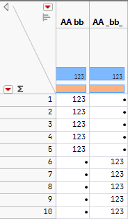

I have an exported CSV that was formed from two or more different sources that have slightly different column names.
No row has data in more than one of those columns. Like on the screenshot below:
How do I combine all of them into one column?
One idea is to use
Combine Columns()
which will result in a Multiple Response column, but since data is non-intersecting, it will be just one number throughout the column. Then force data type to Numeric and modeling type to Continuous. But it produces warning\error.
Any cleaner way to do that?

txnelson
Re: Data cleanup: How to combine several columns with slightly different names and non-intersecting data into one?
I would handle it this way
Names Default To Here( 1 );
dt = Current Data Table();
For Each Row(
	:AA bb = Sum( :AA bb, :AA_bb_ )
Using the Sum() function ignores missing values, so you will get the values you want.
Jim

miguello
Level VII
Jim,
Thanks a lot.
I'm going to use this solution.
I'm trying to script it now so that the column names are not hardcoded.
I'm not quite sure why I'm getting error on this:
For Each Row(
	Column("AA bb") = 1234;
	//Sum( :AA bb, :AA _bb_ )
Error is:
attempting to assign to an object that is not an L-value at row 1 in access or evaluation of 'Assign' , Column( "AA bb" ) = /*###*/1234 /*###*/
