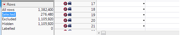

Does anyone know how to make a new data table from the filtered data from the current data table?
I believe it's something like show selected rows();
Attached is the picture
txnelson
Re: Data View of selected from data filter-JSL
go to the red triangle in the data filter, and select "Show Subset"
