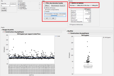

Thank you for your answer, but it's not working fine.
I try to do this. But my filter work only on my TabulateBox, not on my graphs. I don't understand why.
I put the DataFilterContext on all my window. I think put this context on my garphs contener will work but it didn't.
Just a screen to see my app and maybe help :/
You can see my filter is apply to my Tabulate, but not on the two graphs builder.
Thanks per advance for your answers.

swaiper
Level II
Re: Data Filters - auto-update
I resolve my problem. It's because I launch my Filter not with a good way.
Problem solved.

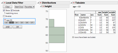

The data table is more of a source object and doesn't respond to data filter exclusions if that's what you mean. However, you can get the exclude effect (but not the selection linking) with a Tabulate table instead.
To get Tabulate to show the data instead of a summary, I added a nominal unique ID column called "row" (name is not unique here because there are two Roberts).
