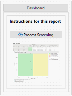

I am using JMP 19 as well. One important difference is that my dashboard contains a Process Screening report (Analyze > Quality & Process > Process Screening) together with instruction text that was added in Dashboard Builder.
In my case, the behavior differs from your example:
  • The dashboard does not display a "Dashboard" header.
  • The instruction text added in Dashboard Builder is not visible after exporting to Interactive HTML.
  • The Process Screening report itself is included in the dashboard.

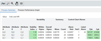

In Dasboard Builder, the dashboard looks like this:

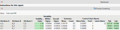

When I Export > Interactive HTML with Data the HTML page looks like this:

Re: Dashboard Builder Text Box Not Visible in Interactive HTML Export
Hi @RegressionPuma8 ,
I think this is a quirk of how JMP operates with HTMLs where it is 'using data' - in this case when using 'interactive html with data' there is no data source (ie a row with the text instructions) for the original text, but there is for the process screening. When you use Export>Html this works fine because it is essentially copying an image of the texts/graphs etc. I would suggest two things: 1) Reach out to [email protected] to see if they can assist further and 2) Add a wish item to our Wish List to request the feature.
