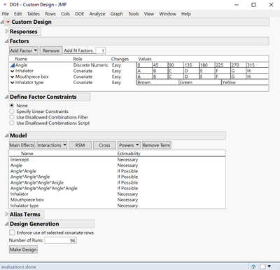

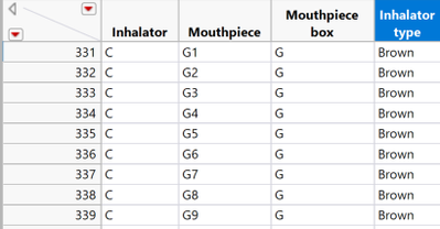

What I've done so far is to create a data table of all possible combinations of inhalator and mouthpiece, 768 in total (example of a row: inhalator from box C, which is a brown type, with mouthpiece G5, see screenshot). From this table I've tried to create a custom design with Inhalator (A, B, ..., H), Mouthpiece Box (A, B, ..., H), and Inhalator Type (Brown, Green, Yellow) as Covariate factors and Angle as a Discrete Numeric factor with 8 levels (0, 45, 90, ..., 315).
When trying to make the above design with 96 runs, JMP thinks for a little and then states that "The selected terms in the Model outline are linearly dependent on the previous terms. Please press the Remove Term button and try again."
It helps if I remove Inhalator as a factor, and I suspect this is were I'm going wrong? Can't I have a design that models both box-to-box variation and type-to-type variation for inhalators? Am I down the wrong path and have to rethink the DOE setup altogether?

Hi Morten,
I think the problem here is -- as you have worked out -- that there is a dependency between Inhalator box and Inhalator type. The model with both Inhalator box (8 levels) and Inhalator type (3 levels) is not estimable. My understanding is that you are interested in the variance in push force between boxes rather than knowing the effect of box choice on push force. In which case, you would ultimately model Inhalator box as a random effect. Similarly I expect that you would model Mouthpiece box as a random effect. In order to design the experiment I think you can take out either Inhalator type or Inhalator box from the model. If you want to get a good balance across Inhalator type, you should remove Inhalator box.

I understand what you're saying and this confirms my suspicion. I'll remove one of the Inhalator factors from the design.
