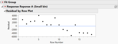

  • Ok, if the order of the experiments is the same as the one in datatable, you may have a measurement drift or a slow drift happening during the experiments. It may be worth to investigate this, particularly if you already have some idea about the source(s).
  • You can still augment your design, but this autocorrelation problem may be hiding/masking some effects, and provoke a mis-estimation of the parameters estimates in the model. If you can solve or reduce this problem and then augment, the newly generated data can help better estimate the coefficients in the model, so your initial set is still relevant (a little less informative maybe as it could have been).

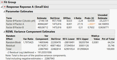

  • Concerning the blocking factor, you can check the Wald p-value in the REML Variance Component Estimates report (not sure if/how this panel appear in JMP 15, here are the explanations from JMP Help Restricted Maximum Likelihood (REML) Method) :
    Here the Wald p-value is at 0,5 so it indicates that the random block effect may not be significantly different from 0. However, this random block effect does capture 64% of your total residual variance.

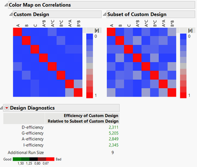

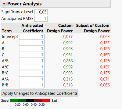

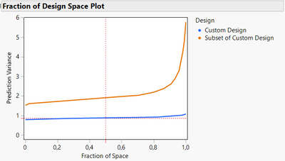

When creating a design using blocking like you did, you group experimental runs into blocks that are similar to each other. The repartition of factors levels should be similar between blocks 1 and 2, so if you can't run experiments of block 2, the situation is similar to using a fraction of the full design. Using only half of the experiments planned in this situation will however results in :
  •  High reduction of power to detect significant main effects and higher order effects:
  • Higher prediction variance :
  • Higher uncertainty for parameters estimates :
  • Increase correlations between effects :
So you may already have detected a significant effect for factor A, both statistically and with a large effect size, but since you're degrading the ability to detect effects (and particularly higher order effects in which you seem to be interested) when using only the first block of your complete design, I would recommend running the other planned experiments from block 2 to better estimate effect from factor A and give you the ability to detect other effects (main effects and higher order effects).
You could also augment the design and changing the ranges of the factors : if A has a predominant effect on your response, you could augment your initial set of experiments from block 1 and restrict the levels/range of A to narrower values centered around the intermediate level (if you had good results in this area). This could help reduce the relative importance of factor A on the response. You could also expand ranges from factor 2, if it makes sense, to enable an easier detection of an effect.
I wouldn't fix a factor at this stage, you have a limited number of factors to study and very low power to detect effect when using only a fraction of your complete design. Fixing a factor so early in the experimentation stages could prevent you from detecting possible interaction between A and B, as well as a more precise estimation of possible quadratic effect of A and its main effect. Maybe the detection of interactions and quadratic effects (not yet detected at this stage) could lead you to a better optimum and a better overview and understanding of your system.
I attached a design similar to the one you seem to have so that you can reproduce the design comparison (full and subset with block 1 only) with the Compare Designs platform.

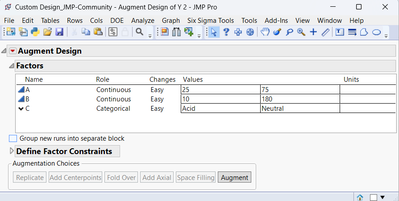

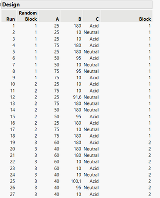

Thanks very much for the follow up. I may have been a little unclear with how I plan to follow up the work from today.
My intention is to run Block 2 of the experiment as originally planned as I realise that it would mess up the design and the ability to glean information from the work performed so far if I did not do that.
"You could also augment the design and changing the ranges of the factors : if A has a predominant effect on your response, you could augment your initial set of experiments from block 1 and restrict the levels/range of A to narrower values centered around the intermediate level (if you had good results in this area). This could help reduce the relative importance of factor A on the response. You could also expand ranges from factor 2, if it makes sense, to enable an easier detection of an effect."
I think what you wrote above seems like the right idea. Expanding ranges for factor 2 doesn't really work in this case as the limits are essentially up against a practical wall so while we could make them wider any value derived beyond those limits just isn't practically useful.
I imagine it must be possible to Augment the experiment once the Block 1 and Block 2 parts are done but my knowledge of DOE's is not great. When I go to use the Augment Design (As a test) the existing Blocking factor in the design comes in as a choice. Should the existing blocking factor be included as an X-factor? When I do that, restrict the value of Factor A around the intermediate value and then then group new runs into a separate Block I end up with a design that's now 26 runs long in total and contains three separate random blocks and 2 Blocks. It appears its blocked the first two blocks into 1 block and then the augmented runs into a second block. It also doesn't contain any additional center points for A which I'm not sure if that's an issue. I do suspect the optimal values is at the midpoint of A so it would be nice to get some additional data at that point but maybe the design doesn't need it?
Please see attached for the design that comes up when I augmented the existing design as described above.

Hi @Students_Tea,
Thanks for the clarification and sorry for my misunderstanding.
If you try to include your Random Block in the panel of the factors in the Augment Designs platform, then the random block factor will be removed in the next window :
 In your situation, what you could do is enter your factors A, B and C in the Augment Designs platform, modify the levels (if needed) for factor A, and check the option "Group new runs into separate block".
With the same assumed model (main effects, 2-factors interactions and quadratic effects), the number of added runs recommended by JMP would be 8, so you can increase this number to 9 (to match the number of runs in previous random blocks from the original design), and you'll get this design (note that I changed min level of factor A to 40 and max level to 60):
As you say, you will have three random blocks, and two blocks.
You could proceed with the analysis by using the 3 random blocks to check that the experimental variance in your experiments remains stable/constant (using a random effect through a Mixed model to assess its statistical significance). If you detect a statistical significance, check the effect size and where is the significant difference between the random blocks.
Hope this answer may help you,

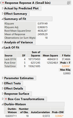

I would recommand looking at your models residuals to better evaluate if the linear regression assumptions are met. I won't copy-paste a previous complete answer I did on this topic, you can look here : Solved: Re: Interpretation related to response model (RSM) - JMP User Community
Relaunching the models you have created, I don't see a specific pattern of heteroscedasticity for response A, but you seem to have it for response B and C. The heteroscedasticity detected in the residual plots and the fact that your responses cover many order of magnitude (from 10-100 to 10000-100000) are strong indications that a transformation may be needed (log or other transformations).
However, the principal problem I noticed in the "Residual by Row" plot for responses A and B is the presence of a non-random patterm, where the residuals follow a tendancy to decrease and becoming negative :
As your random block effect doesn't seem to be significant from the first models analysis, I also launched models without this random effect to check the auto-correlation between points with the Durbin-Watson Test (available in Row Diagnostics), and the test is statistically significant for responses A and B, example here with response A :
Also note the Lack-of-Fit test appears also to be significant, meaning a transformation could be needed and/or terms not included in the model (higher order terms) might be missing, see Lack of Fit.
When trying Box-Cox Y Transformation, JMP recommends transformations with coefficients at 0,485 - 0,32 and 0,334 for responses A, B and C. This indicates that a transformation may be indeed necessary to improve the quality of model fit.
Note however that this won't change or solve the situation about non-randomness of the residuals depending on time/rows.
I would suggest investigating in priority where this pattern may come from, before launching any new tests (unless the order in the datatable is different from the order in which experiments have been done ?).
