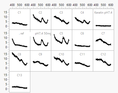

@Bill_Worley thank you and also @Victor_G , it was helpful information - really appreciated. but as you know i have to put some data in the DOE table. how do i take it out from the curves? please advice :)
attached is the FDE of the curves with 2 references - part of the spectra is like the reference and part of the runs gave something else.

@YanivD It would be difficult to succinctly explain what the best modeling approach will be for your data in this reply so, I will direct you to two more blogs that will help you get to the desired endpoint.
The first is for multivariate analysis and advanced pre-processing and the second is for modeling your spectral data which includes FDE/FDOE as an option.  Please review these blog pages and let me know how I can be of help.
Analyzing spectral data: Multivariate methods and advanced pre-processing (jmp.com)
Analyzing spectral data: Modeling options (jmp.com)
