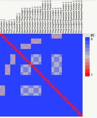

4. If you take your design and go to DOE>Design Diagnostics>Evaluate Design, you may be able to figure out what the appropriate model is?  Here is a color map of correlations:

5. A4, NO.  This has nothing to due with data type.  It is evaluating the aliasing of your design. You should have written the model you were investigating BEFORE running the experiment.
