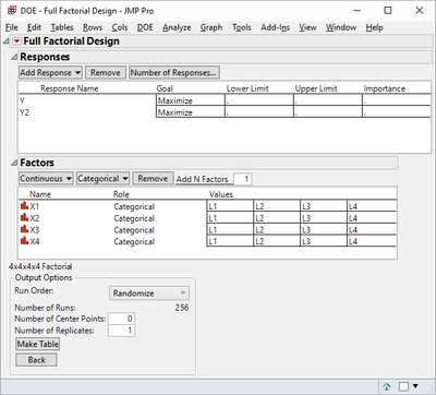

If I am interpreting what you are asking for, you need a Full Factorial Design with 2 Responses, and 4 Factors, each with 4 levels, and 1 Replicate.
It produces a table with a randomized order of all possible combinations times 2.

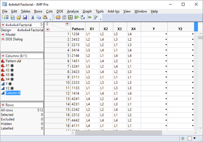

Thank you for your response. That is pretty close! One thing I failed to specify was that I only need each factor to appear once in each pattern.
For Example
1234
1243
1342
1324
