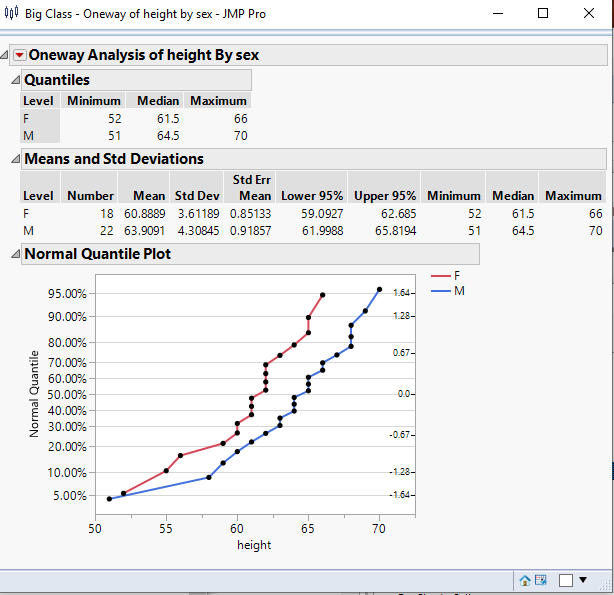

Hi guys!
I'm wondering if there is a way/script to move the minimum, median and maximum in to the Means and Std Deviations area.
Thank you !
dt = Open( "$SAMPLE_DATA\Big Class.jmp",invisible(1) );
ow= dt<<Oneway( Y( :Eval(colListY<<GetItems) ), X( :Eval(colListX<<GetItems) ), All Graphs( 0 ), Quantiles( 1 ), Means and Std Dev( 1 ), Plot Quantile by Actual( 1 ), Line of Fit( 0 ), Points( 0 ), Box Plots( 1 ), Mean Error Bars( 1 ), Std Dev Lines( 1 ), SendToReport( Dispatch( {"Quantiles"}, "", TableBox, {Set Shade Headings( 1 ), Set Shade Alternate Rows( 0 )} ), Dispatch( {"Quantiles"}, "10%", NumberColBox, {Visibility( "Collapse" )} ), Dispatch( {"Quantiles"}, "25%", NumberColBox, {Visibility( "Collapse" )} ), Dispatch( {"Quantiles"}, "75%", NumberColBox, {Visibility( "Collapse" )} ), Dispatch( {"Quantiles"}, "90%", NumberColBox, {Visibility( "Collapse" )} ), Dispatch( {"Normal Quantile Plot"}, "2", ScaleBox, {Format("Percent",9,2 )} ) ), );

Here is a pretty hard coded example of one way to do this:
dt = Open( "$SAMPLE_DATA\Big Class.jmp", invisible( 1 ) );
colListY="height";
colListX="sex";
ow = dt << Oneway(
	Y( :Eval( colListY  ) ),
	X( :Eval( colListX  ) ),
	All Graphs( 0 ),
	Quantiles( 1 ),
	Line of Fit( 0 ),
	Points( 0 ),
	Box Plots( 1 ),
	Std Dev Lines( 1 ),
	SendToReport(
		Dispatch(
			"2",
			ScaleBox,
			{Format( "Percent", 9, 2 )}
// calculate the required new statistics
summarize(byGroup=by(as column(colListX)),byMax=Max(as column(colListY)),
	byMin=Min(as column(colListY)),byMedian=Quantile(as column(colListY),.5)
// Access the report output
repOW = ow << report;
// Capture the names of the columns in the current table box output
namesList = repOW["Means and Std Deviations"][tablebox(1)] << get names;
// Get the values from the current columns in the table box
levels = repOW["Means and Std Deviations"][stringcolbox(1)]<<get;
numbers = repOW["Means and Std Deviations"][numbercolbox(1)]<<get;
means = repOW["Means and Std Deviations"][numbercolbox(2)]<<get;
stddevs = repOW["Means and Std Deviations"][numbercolbox(3)]<<get;
stderrs = repOW["Means and Std Deviations"][numbercolbox(4)]<<get;
lowers = repOW["Means and Std Deviations"][numbercolbox(5)]<<get;
uppers = repOW["Means and Std Deviations"][numbercolbox(6)]<<get;
// Build the new table box adding in the new statistics
newTB = Table Box(
	string col box(namesList[1], levels),
	number col box(namesList[2], numbers),
	number col box(namesList[3], means),
	number col box(namesList[4], stddevs),
	number col box(namesList[5], stderrs),
	number col box(namesList[6], lowers),
	number col box(namesList[7], uppers),
	number col box("Minimum", byMin),
	number col box("Median", byMedian),
	number col box("Maximum", byMax)
// Append the new table box into the Means and Std Devs outline box
repOW["Means and Std Deviations"] << append(newTB);
// Delete the original table box
repOW["Means and Std Deviations"][tablebox(1)]<<delete;

Re: Customize Oneway analysis
Hi txnelson!
Thank you so much for helping once again.
Yes, this was what I was looking for, I'll learn through the code and understand it
