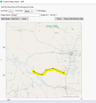

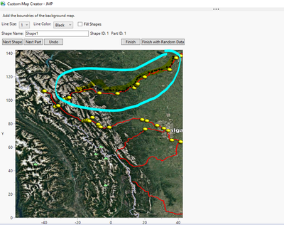

Hi all,
Playing around with the Custom Map Creator add in and I ran into some trouble when trying to construct borders for a river system. When constructing a custom map border using a a background map the boundaries function does not let me to trace the river pattern as accurately as I would hope (see attached photo). Alternatively, when constructing a border from a background photo the boundaries are easily traceable and easy enough to create accurate constraints for the rivers (see attached photo). My problem is that I have concentration data for specific samples based on log data. The end goal is to use the samples to create a contour map of concentration constraint by the river systems. This was my goal in this discussion post:
Question #1: Can I make the constraint the river more accurate in the background map?
Question#2: If constraining rivers for a background map doesn't work how can I use the background photo and sync this to my data set which has log/lat data for concentration in the river system.
