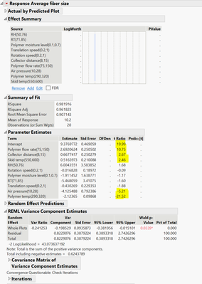

Follow up with the Custom DoE for screening main effects, below is the model fit results. Is it safe to say the factors with t-ratio smaller than 2 can be eliminated and only those factors with t ratios larger than 2 will be used for the optimization design using a RSM next? If p value is available for each factor, I would think the factors with p value smaller than 0.05 should be included in the RSM optimization DoE next. Any suggestions about this thought process will be appreciated. Thanks!

@JMP38401 sorry for the delay...It is difficult to look only at the output you shared and draw conclusions.  It looks like you have an un-replicated design and your model is saturated.  If this is the case, you might want to try getting Normal Plots for statistical significance (sometimes you have to ignore Length's PSE line), Pareto Plots for practical significance and Bayes Plots if you're into Bayesian philosophy (Fit Model>Red Option Triangle next to response>Effect Screening).  The first thing I always do is check for practical significance.  Did you create variation of any practical value?  What is the smallest increment of change in the response that you think is of scientific or engineering value?  After you establish this value, plot the line on the Pareto plot and identify which factors had a practically significant effect.  Then look for these effects on the Normal plot (Daniels Plot).
As far as optimization goes, it is extremely difficult to provide advise with the amount of context you've given.  Please realize optimization is far from just a statistical design.  It requires interpretation from someone who understands the science/engineering.  A couple of thoughts though:
1. You are not trying to create some incredibly complex non-linear model that describes everything.  Models are meant to be efficient approximations that are useful for prediction.
2. You should NOT be doing optimization of design factors unless you thoroughly understand noise.
3.  What did you mean by RSM?  G.E.P. Box implies this is sequential experimentation.  It is not one central composite design.
4. You also should be thinking multivariate.  Doesn't do any good to optimize one Y at the sacrifice of others.

Thank you for the suggestions! I tried to get the Normal plot but all three plot options under Effect Screening were grayed out and not available to show.
"The first thing I always do is check for practical significance.  Did you create variation of any practical value?  What is the smallest increment of change in the response that you think is of scientific or engineering value?  After you establish this value, plot the line on the Pareto plot and identify which factors had a practically significant effect.  Then look for these effects on the Normal plot (Daniels Plot)."
I can estimate the standard deviations for all the factors and know the practically meaningful minimum shift in response but not sure about your suggestion, "After you establish this value, plot the line on the Pareto plot and identify which factors had a practically significant effect.  Then look for these effects on the Normal plot (Daniels Plot)." Can you please elaborate a little bit more on how to do it and why to do it? Thanks!

I guess any factors with an estimated effect larger than the practically meaningful minimum shift on the Pareto chart are significant and they should deviate from the normal line on the Normal plot as well. Should both plots give the same conclusion?

No, you can have effects show as significant on the Normal plot and yet not have any practical significance.

Again,  I can't really help without the data table.
