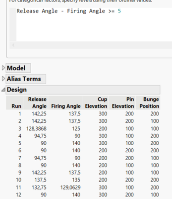

I tried this, but this does not work unfortunately:
Release Angle - Firing Angle >= 5
E.g. this will result in this, where Run 5 is not possible to perform.

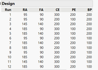

I obtain this design (when specifying only main effects in the model using Custom Design platform) :
Here is the script to generate the design (and datatable attached) :

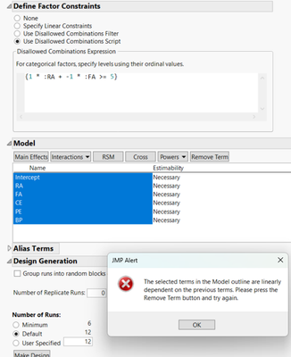

Sadly if I try to run this expression now, I´m running into an error. I even renamed the factors and copied your line into my script and set up only the main interactions, but I still do get this message.
What could be the reason for this? I´m using JMP17.
Thanks in Advance!
Victor_G
Re: Custom DoE: How to set up Factor Constraints with Script
Try to specify your constraint using the "Specify Linear Constraints" instead of the "Disallowed Combinations Script".
