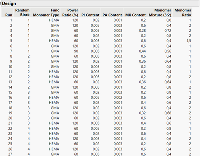

      Could you explain the role of random block in your case ? Is it a limitation of number of runs per day ? If yes, you can add the number of runs per block at the end of the DOE generation, which can increase the recommended default number of runs to 27 (4 blocks, 3 with 7 runs and the last one with 6 runs) :
      I also saved this design in a script in your original datatable, and here is the script to generate it :

  2. When evaluating Mixture design using Evaluate Designs platform, you can look at informations related to predictivity, like Prediction Variance Profile, Fraction of Design Space Plot, and Design Diagnostics like G-Efficiency and Average Variance of Prediction (related to I-Efficiency), like mentioned in the JMP Guide. The goal of this evaluation would be to get an understanding about the predictive performances of the design used.
    Note that it can be difficult to evaluate a design without any reference design/benchmark, so I would recommend creating several designs and use the platform Compare Designs to better assess the pros and cons of each design. You can vary the number of runs, complexity of the model, optimality criterion, etc...
    You don't have these informations displayed or accessible as you have Random Blocks in your design. Using the Evaluate platform and specifying your factors without the Random Block (or changing it's design role from "Random Block" to "Blocking" and including it with the other factors) will help you find the Maximum Prediction Variance and get access to Design Diagnostics.
  3. Mixture designs are quite different from other designs (like factorial designs), as the factors are not independent : changing the level of a mixture factor has an impact on others, so mixture factors are correlated. Also, the emphasis of this type of design is more on predictivity and optimization than screening/statistical significance. Last, you have chosen a model-based mixture design (not a Space-Filling approach), so you already have assumed a possible complete model you would like to investigate.
    For these 3 reasons, it doesn't make sense to evaluate a mixture design based on power analysis. For modeling, it makes more sense in the analysis to start from the full model with the possible terms you have assumed in the design creation, and start removing terms in the model (except main effects), based on the predictive performance of the model (RMSE for example) or Information criteria (AICc/BIC), NOT on individual p-values/logworth of each term (because of multicollinearity/correlation among mixture factors, no intercept in this type of model, p-values/logworth are not a valid metric for model selection).
    For design creation, as mentioned in point 2, you can create different designs and compare them based on prediction performances : prediction variance profile, fraction of design space plot, G-Efficiency and average variance of prediction, etc...

    1. The random blocking was indeed added to account for the max number of runs per day!
  2. I followed your advice to compare the designs. I have a follow-up question if I may:
    1. It's noticable that upon comparing the 'Added Factor' custom design with the 'Added Factor with Random Blocks' design, the over-layed Fraction of Design Space Plot differs to each table's design space plot if opened individually (Fig 2 below). i.e. The prediction variance for the blocked design is all of a sudden lowered in the comparison design space plot. Is that because I had selected to match certain factors to compare?

  1. It's difficult to compare the two designs mentioned, as 'Added Factor' design has no blocking factor. So JMP is comparing the design only for common factors based on the other factors, levels, repartition of runs and number of experiments, hence a slightly lower prediction variance for the 'Added Factor with Random Blocks' design, as it has more runs (27 runs) compared to the original 'Added Factor' design with 24 runs (without taking in consideration the blocking factor of the 27-runs design).
    But to evaluate designs in a situation where you don't have exactly the same factors or same structuration of experiments (in blocks for example), it's best to compare the designs based on the outcomes of each individual "Evaluate" platforms.
    In the second design, as you impose a condition on the randomization of runs through blocking, each random block should contain similar experiments between each blocks, so you end up with different runs when you're in an unconstrained situation. You typically end up with "less diverse" experiments in a situation with blocking than in a situation without it, so prediction variance might be slightly higher (all other parameters kept constant, like number of runs, optimality, ...) when you add blocks. In your concrete situation, you can check that design 'Added Factor' has more runs at the middle levels for factors than the design 'Added Factor with Random Blocks'.
  2. As you're in a mixture experiment, I would recommend to start with your full assumed model with a regression model. Depending on the adequacy of your model, you can :
    • Augment your initial design if the model is too simple for your use case. You can check this underfitting by looking at the residuals patterns, and performance model metrics like RMSE, and the accordance of the model with your domain expertise.
    • Refine your model if your full assumed model is too complex for your use case. Again, you can remove some terms based on their impact on the predictive performance (RMSE) or based on Information criteria (AICc, BIC...) that balances the complexity of the model with its predictive accuracy. Always make sure that your process is guided by statistics and domain expertise.
      Use visualization tools like Prediction Profiler, Contour Profiler, Surface Profiler, Mixture Profiler etc... to visualize and assess the relevance of your model based on your domain expertise.
