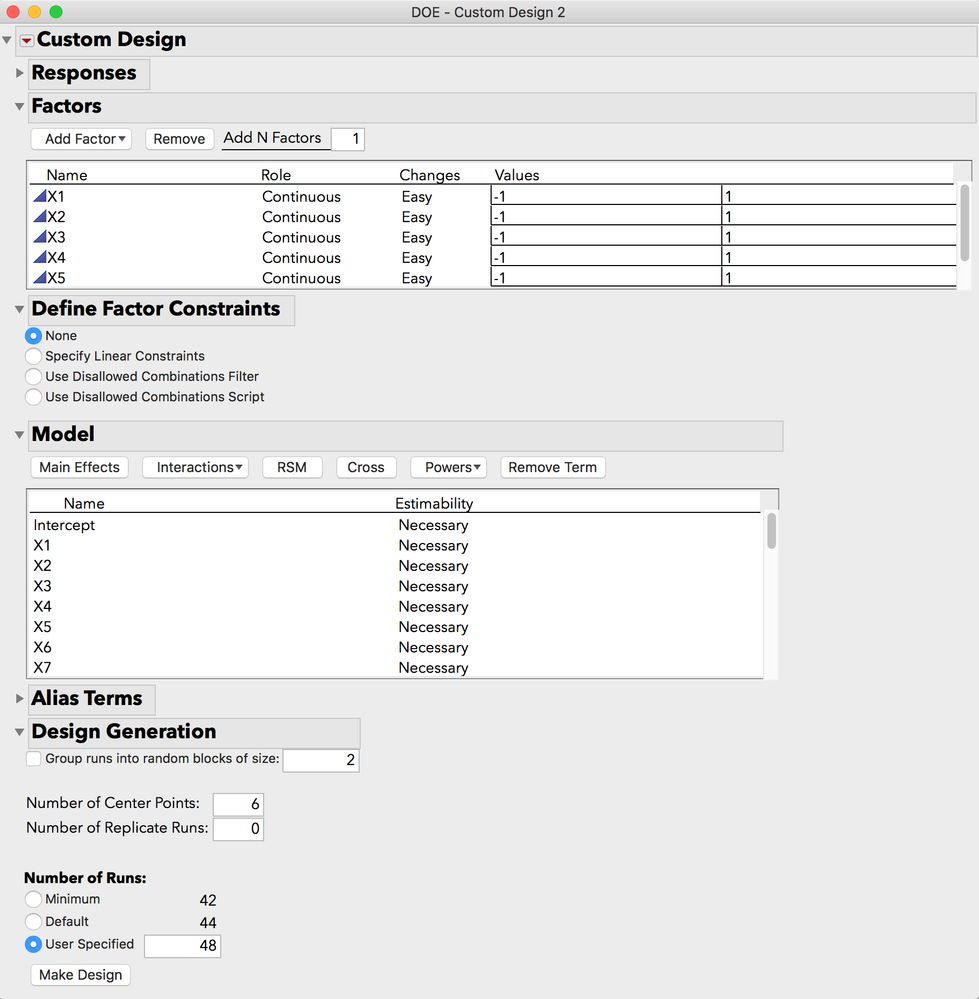

louv
Staff (Retired)
Re: Custom Design - I-optimal - center points not added
Your attachment indicates that you specified "6 replicate runs" rather than "6 center points"
I added 7 continuous factors with an RSM Model and then chose I-optimal criteria and  6 center points and entered 48 runs.

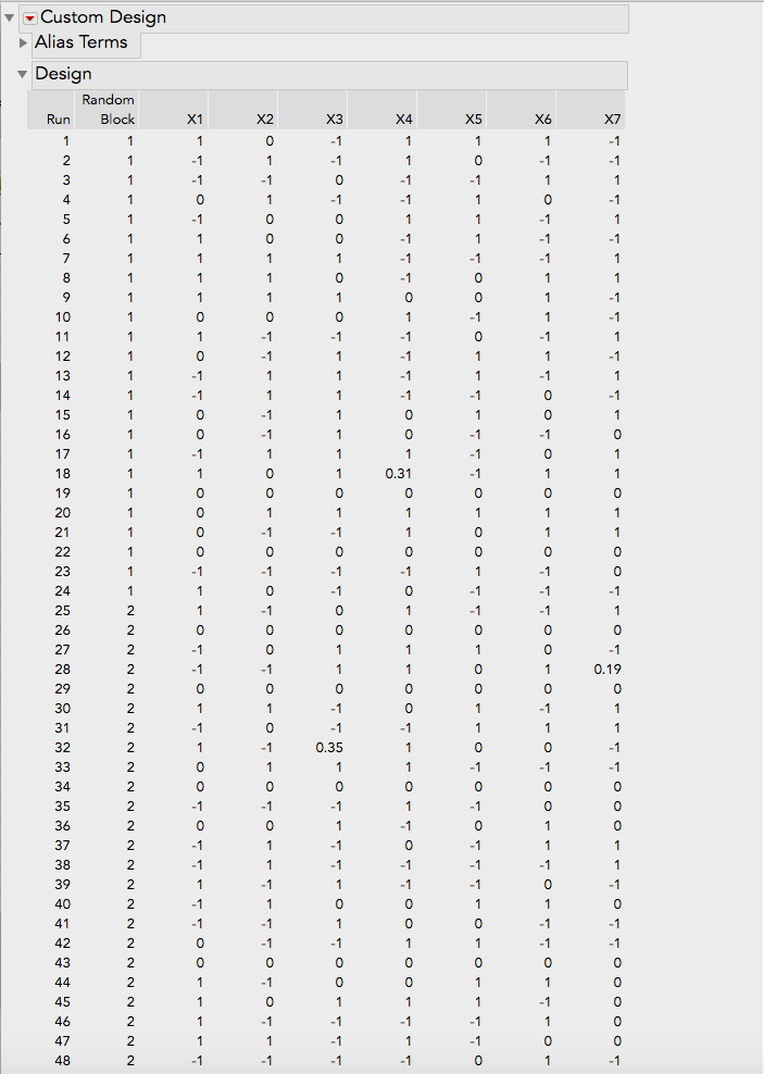

joberi
Level I
So that is it - first, I go "Custom Design", I put in 7 contiuous factors, click ok, then click "RSM", add a tick to the blocks and type 24 into it, add "6" to the Center Points and then specify 48 for the Number of Runs.Then make design and get the table as shown. Only 3 center runs are there now.
Thanks!

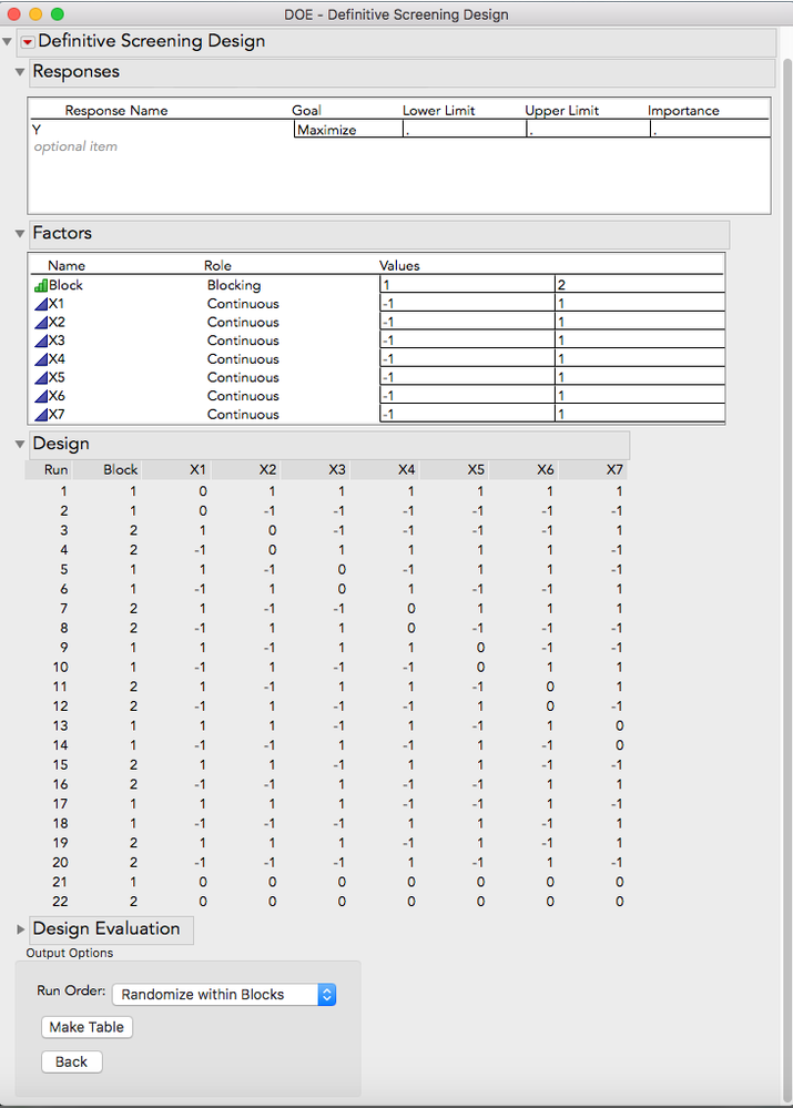

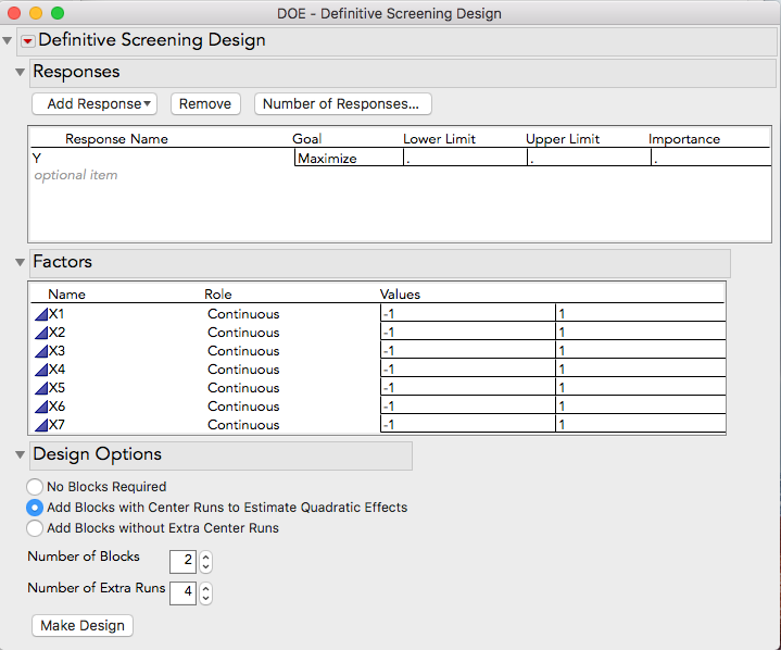

louv
Staff (Retired)
Not sure why you are not getting your desired number of center points. I was able to get all 6 center points although I often have to start the platform from scratch and re-enter my settings to obtain the design I am looking for with respect to balancing the center points within the block. Also there are times when I would simply just have a design for N=42 in your case and manually add my 3 center points per block for a total of 48 runs to get the desired scenario since the optimality criterion will at times result in an unbalance the number of center points per block.
Just out of curiosity have you investigated the use of the Definitive Screening platform for this scenario. The number of runs would be considerably less. If you already know that the factors are active and screening has already been completed than you can ignore this last question.

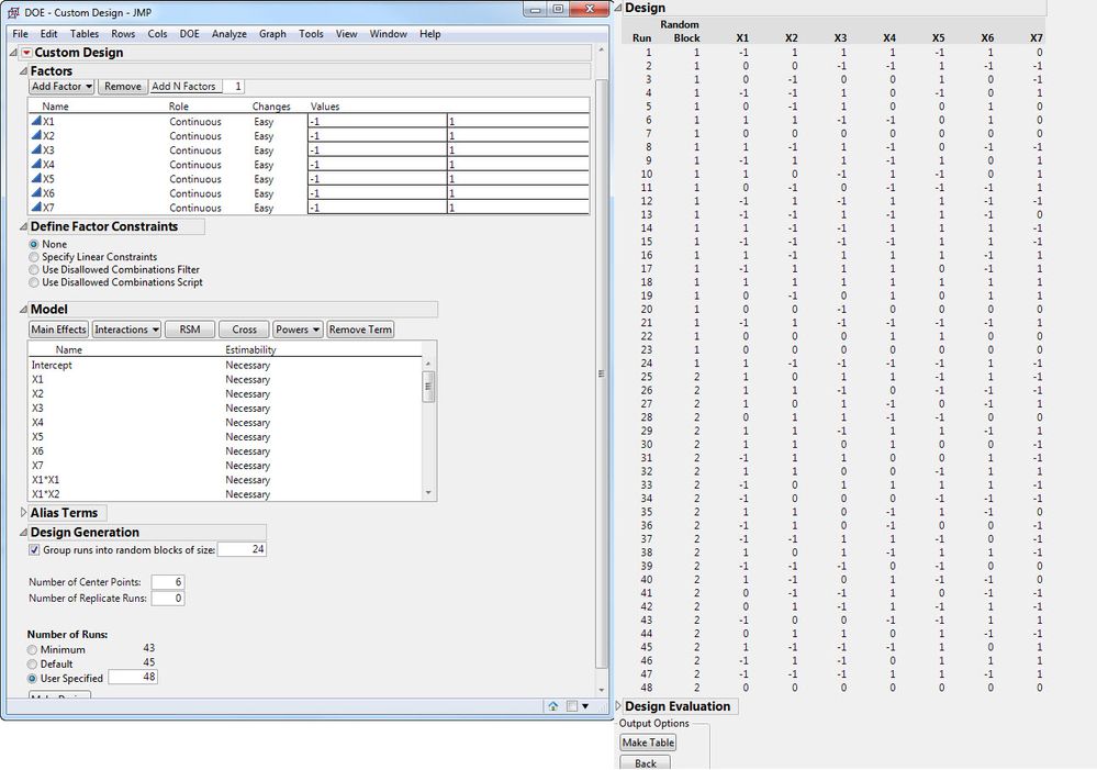

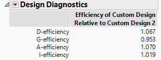

David_Burnham
Super User (Alumni)
I followed your steps using JMP 13 on WIndows and got the centre points as expected.
Regarding whether it is better to include centre points when you generate the RSM rather than after: It is "better" in the sense that the algorithm will take account of the presence of the centre points (that it true for recent versions of JMP, it wasn't true for earlier versions). But since I-optimal designs don't really derive much benefit from centre points adding the points after the design is generated will have neglible impact.  I created designs using both routes and did a design comparison ('custom design' had centre points added at the time of generating the design, and with 'custom design 2' I added the centre points myself after the design had been created).
