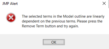

Using the custom designer platform, we tried to add mixture factors or use a script for disallowed constraints but nothing worked so far. Using the script we got the error message:
How can we add this linear constraint anyways?
