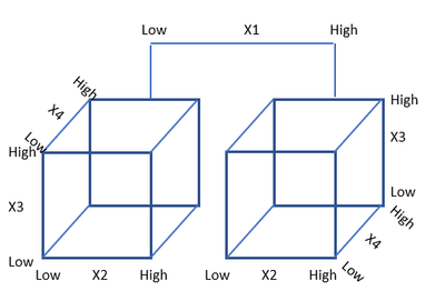

Hi @DualARIMACougar : I've usually seen it displayed something like this. For higher dimensions, just keep on going...though the pic can get huge in a hurry.
