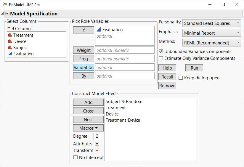

I meant 'matched pairs' in the general sense of blocking, not the specific sense of the Matched Pairs analysis. That analysis is not appropriate because it is a one-sample t-test of the mean. You have a two-way design with a random effect.

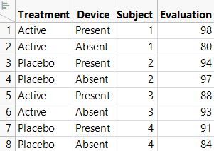

So I mocked up your data:
This set up allows me to specify this model for the analysis:

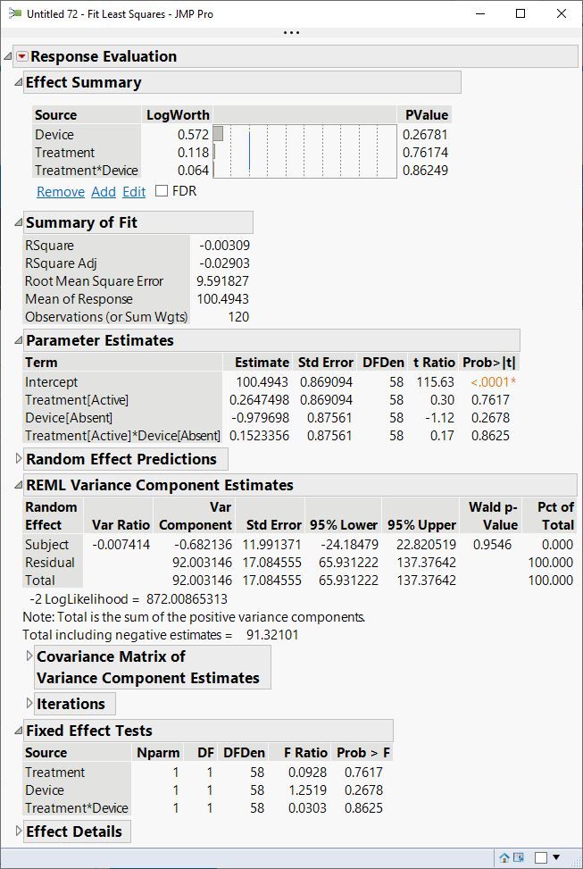

There are no fixed or random effects in the simulated response in this mock up. The results available are:

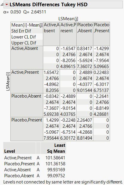

Multiple Comparisons: open the Effect Details outline, click the red triangle next to the interaction term Treatment*Device, and select LSMeans Tukey HSD.

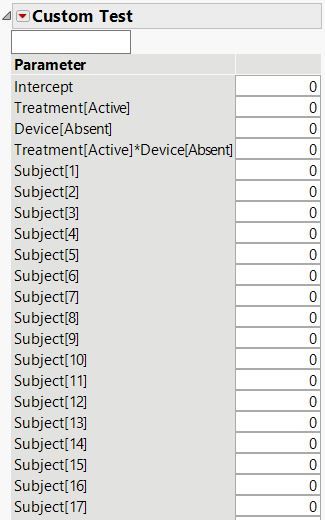

Custom Tests: click the red triangle at the top of the platform, and select Estimates > Custom Tests.
Use this interface to construct one or more custom tests and the joint test.

My understanding is that my primary interest is in the Tukey HSDs report where I believe the LSMeans Differences table has a red arrow that allows the "Ordered differences" report.  In the Ordered Differences report it lists each comparison of the differences between the means along with the p-value of the test.  This p-value is the summary statistic of the test comparing the two means.  Sound right?
