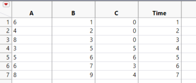

Hello Folks,
I am trying to overlay create a variable y axis to plot multiple parameters using my columns.
my time being the x axis.
Example if click on A and B they should overlay. Or if I click A and C etc.
Can I create a data filter of columns as my y axis and when i click on them they will populate the graph?
I am currently using a different software to do this and you have to change names . but you like to do it in JMP.
I can create the static overlay but that means I have to pre script my variables.
sorry can post plot of data but software i use would overlay A,BC
if my question is unclear please let me know?
Jason
txnelson
Re: Creating variable Y axis to plot/overlay parameters
Using Graph Builder, overlaying columns A, B and C is a simple matter of selecting all 3 of the columns, and dragging and dropping them on the Y drop area.  Then dragging the Time column to the X drop area
Yes makes sense I was trying to over complicate it.
