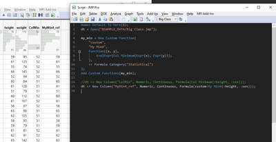

Related to this wish list item I created: Add normalization and robust statistical functions (and matrix functions) . I thought I could just try to write these as custom functions for now (even though I know it will be impossible to share them and have them updated for everyone), but I faced my first problem almost immediately: how to reference columns... When using Custom Formulas am I stuck using row-level calculations or referencing columns as strings instead of :colname which would prevent me from using them directly from Formula Editor.
Names Default To Here(1);
my_min = New Custom Function(
	"custom",
	"My Min1",
	Function({x, y},
		As Constant(
			vals = Column(x) << get values;
			groups = Column(y) << get values;
		cur_group = Loc(groups, As Column(y));
		vals[cur_group[Loc Min(vals[cur_group])]];
	<< Formula Category("Statistical")
Add Custom Functions(my_min);
	"custom",
	"My Min2",
	Function({x, y},
		Col Minimum(Column(x), Column(y));
	"custom",
	"My Min3",
	Function({x, y},
		Col Minimum(x, y);
dt << New Column("ColMin", Numeric, Continuous, Formula(Col Minimum(:height, :sex)));
dt << New Column("MyMin1_str", Numeric, Continuous, Formula(custom:My Min1("height", "sex")));
dt << New Column("MyMin2_str", Numeric, Continuous, Formula(custom:My Min2("height", "sex")));
dt << New Column("MyMin3_str", Numeric, Continuous, Formula(custom:My Min3("height", "sex")));
dt << New Column("MyMin1_ref", Numeric, Continuous, Formula(custom:My Min1(:height, :sex)));
dt << New Column("MyMin2_ref", Numeric, Continuous, Formula(custom:My Min2(:height, :sex)));
dt << New Column("MyMin3_ref", Numeric, Continuous, Formula(custom:My Min3(:height, :sex)));
-Jarmo

Does this do what you want?  It looks like you need to explicitly evaluate the function parameters if you expect them to be column references.
	"custom",
	"My Min4",
	Function({x, y},
		EvalExpr(Col Minimum(Expr(x), Expr(y)));

That doesn't seem to provide correct answer as it is most likely evaluating them "row by row" and not as columns

Good point!  I was so focused on getting the column references to evaluate, I didn't even notice that the values were nonsensical.  I'll think about it more.
