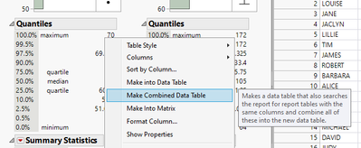

Hi @mattdalp ,
Try right clicking in one of those tables and select 'Make into Combined Data Table'.

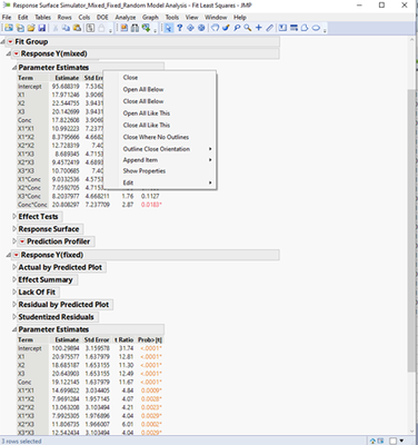

Thanks for the speedy reply! I just tried your suggestion and do not see an option to do so. See my image below: I am analyzing two responses, Y(mixed) and Y(fixed), and am trying to somehow develop a way to quickly merge/copy/etc their "estimate" data found in the Parameter Estimates tables all at once. For additional context, I am exploring different DoE designs simulated in the presence of multiple fixed and random sources of variation to assess their impact on the quality of the final model. While only 2 responses are shown below, a good simulation would require 1000's of runs, which is very hard to do when copy/pasting by hand.
I also have very limited coding experience, so I am hopeful to find a workaround without having to learn JMP scripting if at all possible.

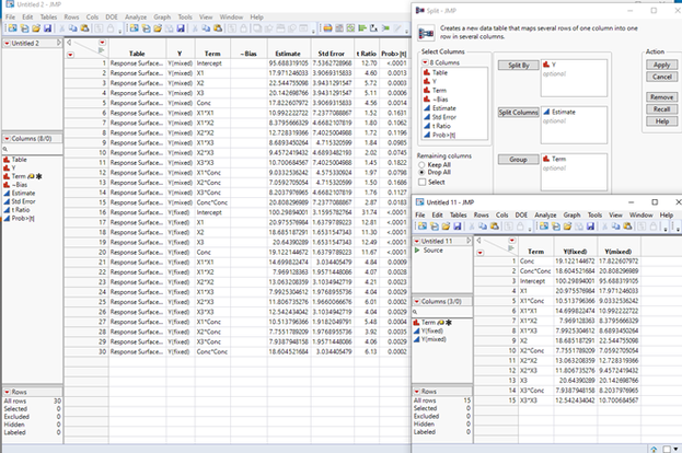

I swear I had tried that, but isn't that just how things go? I was able to generate a combined table, and then use the Tables > Split option to generate what I was looking for. Attaching a screenshot reference below for anyone else who may be curious!
Thank you to the JMP team for all the help!
