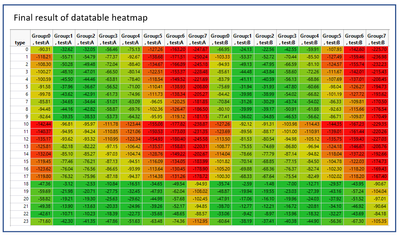

Hi,

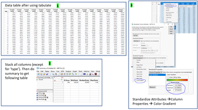

I have a lot data that I like to plot as a heatmap from a data table. I have attached an image below of a sample data table image and the steps I do to create the heatmap on the data table. It follows the following steps:
  1. Get a datatable after using tabulate
  2. Stack all the columns (except for 'type'). Then do a summary of the whole data set to find min, median and max.
  3. Take the min, median and max values from step2 and put them into the color gradient values.
The result of the data table after running these steps is shown below. Currently I do step 3 manually where whatever value I get post Summary I input into the color gradient values. Is there a way to take the values (min, median, max) from Summary datatable with a script and input it into the color gradient?
I have attached the sample dataset as well.

Thanks for the input! I am using your script as a good starting point but I was hoping to make it more dynamic.
  • So in the script you manually set the max, min and mid to values is there any way for them to be set by the output summary table in step2 in the image. Basically this max, min and mid are in the scope for Group:0 test:A I would like to get the scope max, min and mid for the whole table.
  • I had to add Color Cell by Value(1) into my script and I have been trying to set reverse scale as well and have been getting error messages any idea how to do this?
  • Also is it safe to assume that to run the color gradient on all columns I would need to but a for loop outside of the code you sent? Or is there another way to do this?

Thanks this is very close to what I need! The only thing off is that the heat map gives the gradient based on the max, min and mid for that column instead of from the whole datatable. Basically in the code below I want to find max, min and mid before I enter the for loop to color the cells. When I do this the functions Maximum, Minimum and Median do not recognize the colList being passed to extract max value. Is there a way for jsl to find the max, min and median based on the list when running get column names? Or does this need to go into a for loop?

Thanks for all the input and help! I was not aware of scripting index it was a big help. I posted the code I am using below as my final version
