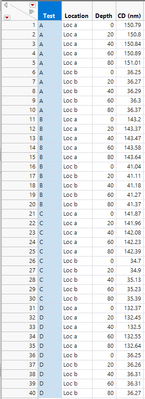

I am plotting CD vs. Depth plot, for total 8 sets in the example (A-a, A-b, B-a, B-b....).For each Test A~D, there are 2 different 'Location' a and b.
I'd like to pick 2 set specifically and create a delta plot; for example, If I select A-a and B-a, CD values are subtracted at each depth and CD vs. Depth plot should be generated.
Is this something I can do at JMP? I was trying to do this in excel using xlookup function, but since the amount of data is huge (30000+ rows) it is just too slow. I am not sure if this something I can do at JMP.
Example data set
Example CD vs. Depth plot;

Sure, here is the example data file.
I am looking to get the delta value between two pair, so yes I'd always pick 2 for comparison.
Location may not be the same, in the real data set I have some samples that have more locations. I also need to compare sample to sample as well as location to location. For instance, sample A-a to sample C-b

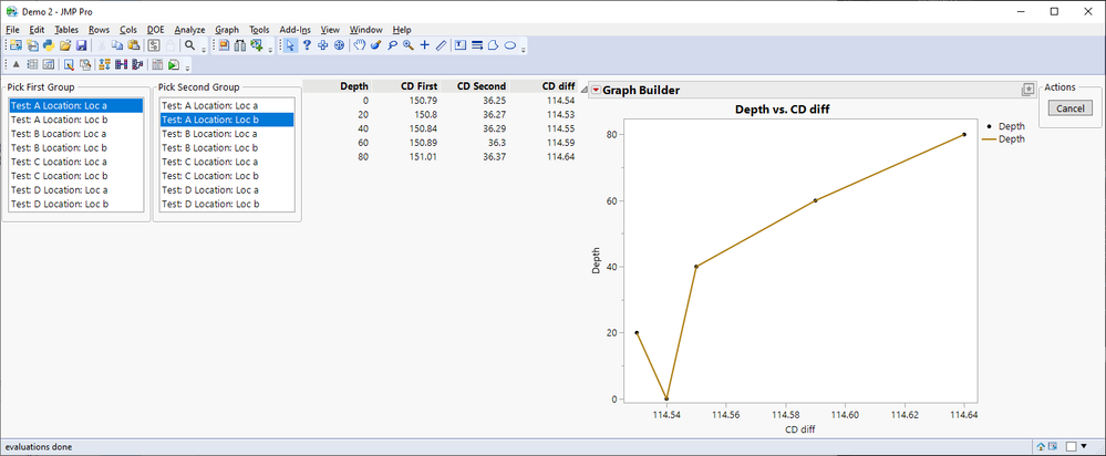

Re: Creating delta values plot between two subsets; want to select 2 'tests' to compare among multiple test values
With scripting you can create things like this (this is missing some sanity checks)

nw = New Window("Demo",
	H List Box(
		Panel Box("Pick First Group",
			lb_first = List Box(groups)
		Panel Box("Pick Second Group",
			lb_second = List Box(groups)
		Data Table Box(dt_temp),
		gb = dt_temp << Graph Builder(
			Size(525, 454),
			Show Control Panel(0),
			Variables(X(:CD diff), Y(:Depth)),
			Elements(Points(X, Y, Legend(11)), Line(X, Y, Legend(13)))
		Panel Box("Actions",
			Lineup Box(N Col(1),
				Button Box("Cancel")
lb_first << Set Max Selected(1);
lb_second << Set Max Selected(1);
lb_first << Set Script(update_expr);
lb_second << Set Script(update_expr);
Eval(EvalExpr(
	nw << On Close(
		Close(dt_temp, no save);

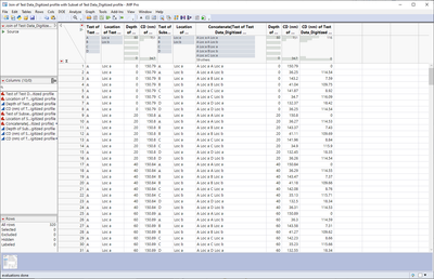

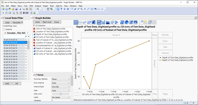

I think you could also duplicate your table so you can do a self-join with "duplicated" columns, join it to the original table by depth, remove self-joins, create grouping selector, formula for differences and create a plot
And this is easy to automate in JMP.
