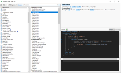

To confirm something basic that doesn't seem to be explicitly stated in the material: when defining a function, is 'this' a pre-defined term in JSL that will point to whatever object the function is attached to? I see some examples that use 'this' in the set function argument without is appearing anywhere else in the function definition (I'm about 60% sure I'm using the correct terms). The basic mathematical functions are intuitive such as MyFn = function ({x,y}, x + y ), but then things seem to ramp up in complexity very quickly when we get into objects.

It is just the first parameter when used with << Set Function (as in it doesn't have to be this, seems like JMP17 scripting index is using thisBox for example). And that first argument is a reference to that specific box in which that function is set to.  This help page might provide some more information with some examples:
Scripting Guide > Display Trees > Construct Custom Windows > Set Function and Set Script
Also, with some display boxes you might be able to use multiple parameters with << Set Function . You can see these in scripting index (if you can find them, might be a bit tricky sometimes)
