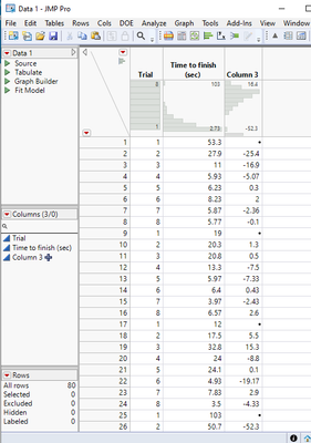

I would like to know how to create a formula that checks the differences between the rows.
For example, I have here a file (Data 1) with a column of trials from 1 to 8 (several sequences).
Another column contains the time parameter.
How do I create a new column that checks the time differences between trials 2 and 1, 3 and 2, etc.
Thanks.

Based on the provided data, Lag() or Dif() should work
If(:Trial == 1,
	Dif(:"Time to finish (sec)"n)

Yes, it works.
Thank you.
