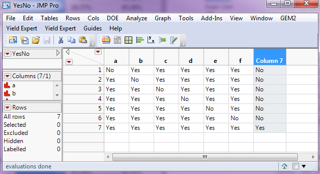

The formula I listed is not a question of doubt.  It works. See image below and attached fileyesno.PNGyesno.PNG
What may be of issue is that your data may have mixed case.  "No" is not equal to "no", or "NO".  If this is the case, then I suggest
If(
	Uppercase( :A ) == "NO", "No",
	Uppercase( :B ) == "NO", "No",
	Uppercase( :C ) == "NO", "No",
	Uppercase( :D ) == "NO", "No",
	Uppercase( :E ) == "NO", "No",
	Uppercase( :F ) == "NO", "No",
	Uppercase( "Yes"
Also, please note the ":" in front of each column name.  This is important for JMP to understand that it needs to look into a column by the specified name
Jim
rj69
Level III
Re: Creating a column with yes/no value based on 6 other columns with yes/no values
Jim,
Thanks for the follow-up. I figured it out. I needed to do a few things:
  • I had to adjust your formula, because I was looking for the "opposite" outcome. My intent with your example would have yielded "Yes" values for all records in Column 7 since at least one "Yes" was present in each of the 7 rows. The only way a "No" would have been returned if a record featured "No" values in all columns a-f.
  • But that wasn't enough, as I initially had all "No" values for my new column. I wondered if different data types in the reference columns were throwing off the matching. Yes, the data types were listed as Integer while I was trying to match to a column with Character data type. (My original source file was converted from SPSS and I overlooked the column type.)
  • I changed the data types to Character, and also noticed Value Lables were being used, so the "No" and "Yes" were actually zeroes and ones. I went back to the formula and changed replaced the "No" and "Yes" with 0 and 1, and that's when it worked.
Good to know about the case sensititviy and ":" protocol. Still relatively new to JMP and I don't use it as often as I'd like. Thanks again for your help.
Robert
