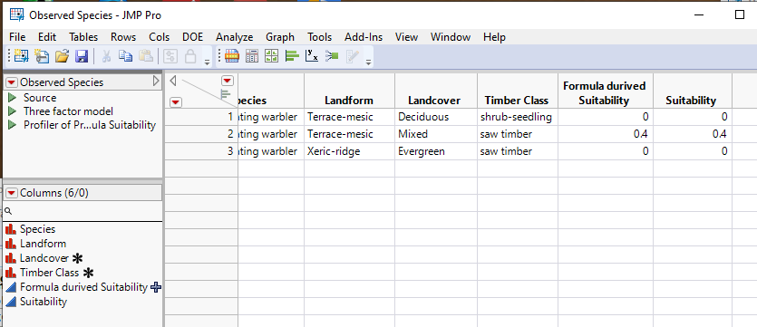

Here are two ways of handling your lookup.  The first is a formula that I created and applied to a sample table with just 3 entries.  It looks up in the WEWA suitability matrix data table and pulls in the suitability value.  It is a fine formula, but not very efficient.
Here is the formula used for the column "Formula durived Suitability"
If( Row() == 1,
dt = Data Table( "WEWA suitability matrix with data" );
dtLookup = Data Table( "WEWA suitability matrix" );
Show( dt, dtlookup );
curSpec = Uppercase( dt:Species );
curLandForm = Uppercase( dt:Landform );
curLandCover = Uppercase( dt:Landcover );
curTimber = Uppercase( dt:Timber Class );
x = .;
Try(
x = dtLookup:Suitability[dtLookup << get rows where(
Uppercase( dtLookup:Species ) == curSpec & Uppercase( dtLookup:Landform ) == curLandForm & Uppercase( dtLookup:Landcover ) ==
curLandCover & Uppercase( dtLookup:Timber Class ) == curTimber
)][1],
x;
The second method, that creates the column called "suitability" is created by using the Update platform in JMP..  Here is the script for it's creation
names default to here(1);
Data Table( "Observed Species" ) << Update(
	With( Data Table( "WEWA suitability matrix" ) ),
	Match Columns(
		:Species = :Species, :Landform = :Landform, :Landcover = :Landcover,
		:Timber Class = :Timber Class
P.S.   The data table called Observed Species starts out with only Sepcies, Landform, Landcover and Timber Class as the columns.

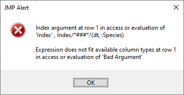

Both of your solutions make sense to me. I'd prefer the formula driven solution. I went ahead and copied the formula from your "formula derived.." column in the Observed Species table you created into a second JMP table where I am actually calculating the habitat suitability indices (attached). When I try to apply the formula I get the following error:
I'm not sure how I would fix this. Would you mind taking a look at the "formula derived suitability column) in the attached JMP data table and letting me know where I might have made an error? Thanks again for your help. Casey

Re: Creating a JMP formula to pull values from a look up table with four categorical variables
There are a couple of issues.  I do not know what version of JMP you are running with.  I developed the formula in JMP 16, which apparently has a bug.  Therefore the formula was changed when I saved it in JMP 16, from what I had tested it with.  I will be reporting the bug after I finish responding to you.  The correct formula to use is:
If( Row() == 1,
x = .;
Try(
	)][1],
x;
I also edited this formula in my last response, so no one should have an issue with it.
In the latest data you supplied, there is a mismatch with the lookup data table.  You have changed some of the lowercase letters to uppercase.  The original formula I wrote does not compensate for this.  In the current version, I forced all of the lookups to be done with uppercase so that should no longer be an issue.

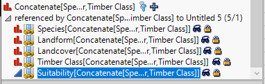

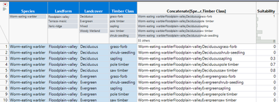

You could maybe also try using Virtual Join.

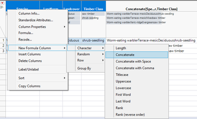

Create linking column (for example concatenate all four grouping values) to both of tables you have:
And then perform virtual join:
Table with suitability as Link ID:
Table which you want to pull stuff to:
If I remember correctly virtual joins did require you to have at least the datatable which will be Link ID saved.
