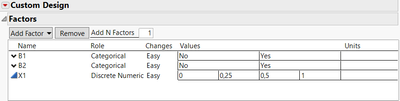

I would set up the factors like this (the levels names may have to be modified):

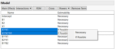

Regarding your needs, I would set up a model containing main effects and 2-factors interactions, the quadratic and cubic effect of X1 are added automatically as "If needed" due to the discrete numeric factor type of X1, but you can change the estimability of "Necessary" if you would like more balanced runs between the 4 levels of X1, by selecting the two terms and clicking on their estimability levels :
