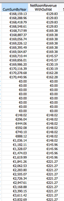

Re: Creating a Cumulative Summary Column for different rows
Thank you Michael, now both years work but whenever the formula faces a 0.00 value (there are days when there is no revenue) the CumBySumYear starts calculating from zero which ends irrational results.

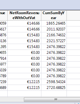

That's strange. When I try putting a 0.00 value in :NetRoomRevenueWIthOutVat, the :CumSumByYear value is the same as the previous row's value:
