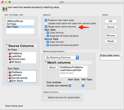

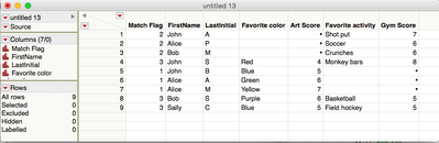

There's a "Merge same name columns" option in the Join dialog that will do as its name suggests and get you one set of First Name and Last Initial columns.
In your example, you've got a column named Score in each table so you'll need to rename them to Gym Score and Art Score. After doing that you can complete the Join dialog like this:
And you get a data table like this:
The Match Flag column indicates which tables contributed to each row. 1==Main Table, 2==With Table, 3 == Both.
I think that's what you're looking for, or awfully close anyway.
