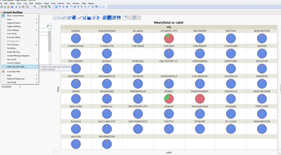

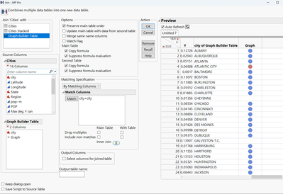

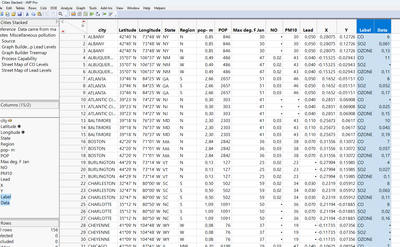

1. You can make a Graph into a Data Table. Here, I created the Pie Chart and used the Wrap field to have one per City:
2. The Table is just containing the label and the graph in two columns. So you need to join it with your inital table (Table > Join)

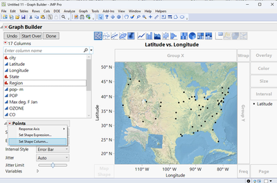

3. Create the Graph and select the Graph Column as Symbols
Result:

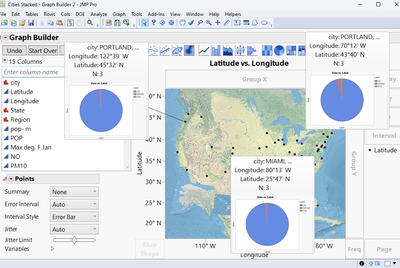

1. Create the Pie Chart (without any filtering)
2. Create the Geographic Map Chart
3. Right Click a data point in the Geographic Map Chart and add a Hover Label
The Result is a Map with Labels showing the relative abundance of your variable (species) per location (Sweet benefit is that these Hover Labels are actual Graphs themselves, so you can drill down into a specific location by clicking on it):

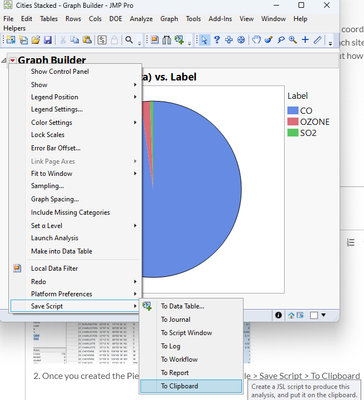

1. Create Pie Chart in Graph Builder. You might need to stack you data first:
2. Once you created the Pie Chart, go to the Red Triangle > Save Script > To Clipboard

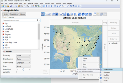

3. Create the Map Graph, right-click a data point and add the Hover Label via 'Hover Label' > 'Paste Graphlet'
Note: 'Paste Graphlet' only appears if you have copied a script to the clipboard before.

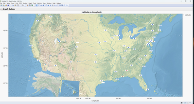

Fantastic, thank you very much Florian. How difficult would it be to now have the "pies" as markers instead of having them popup when one hovers over a point? This would be nice to produce a static map with all the information.

Steps you can achieve this are:
1. Create a Column of Graphs
2. Create the Graph
3. Select the Graph Column as the Symbols
Here's a way:
Result:
In my example here the graphs are a bit small as Icons, so you might need to adjust the graphs size a bit.

Thank you again Florian. No wonder I love JMP! Yves
