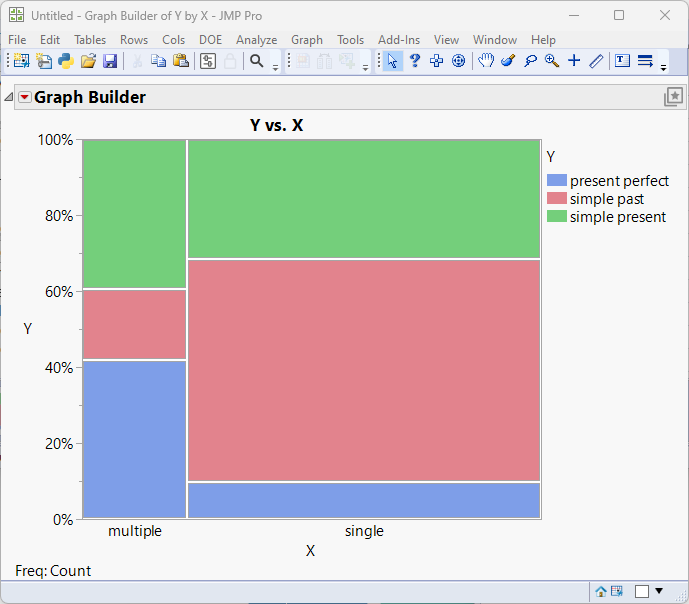

Hi, everyone. I'm a new user. I'd like to know if we can create mosaic plots using the data as summarised in the table. Please give me advice. Thank you.
 Simple pastPresent perfectSimple present
Single1753293938
Multiple166374352
 19196671290
1 REPLY 1
Re: Create mosaic plots using summary data.
Yes. Use Graph > Graph Builder. You need a trick (I believe) in this case. After it opens, click the red triangle at the top and select Redo > Relaunch Analysis. Cast your variables into the X and Y roles. Cast the Count data column in the Freq role.
Please see the attached data table with your data and a table script to launch the mosaic plot in Graph Builder.
