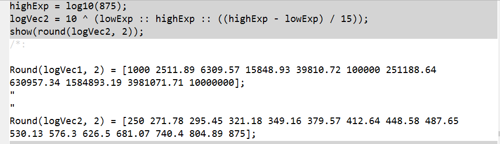

//ex2: generate 14 logarithmically-spaced points between 250 and 875
lowExp = log10(250);
highExp = log10(875);
logVec2 = 10 ^ (lowExp :: highExp :: ((highExp - lowExp) / 15));
show(round(logVec2, 2));
