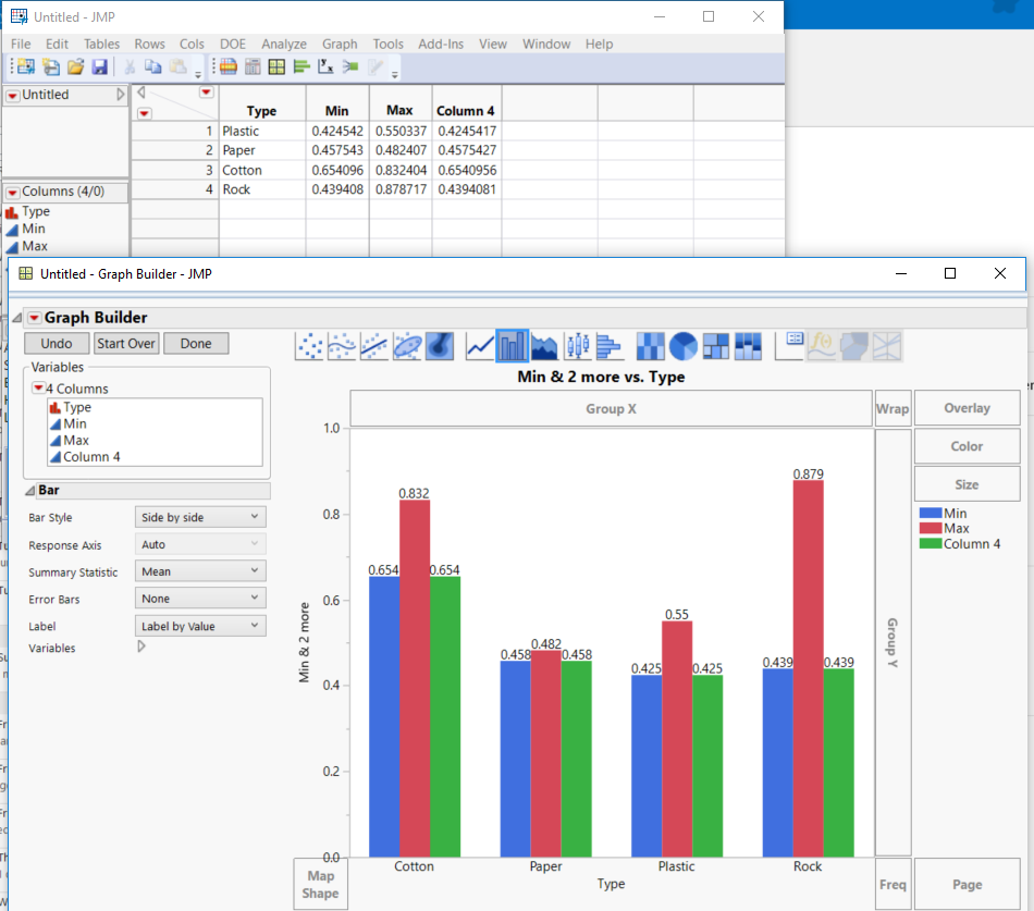

Hi all,
im still new to JMP scripting. I need help to create a formula to make the value as a variable but with its own name. What i mean is as below. So, i want to create a formula that can make column 4 below as a variable for distribution graph.
it is like Plastic = 0.424542
the problem right now is the formula name will be in the same which is t4 = :TYPE;:MIN;. So if i want to plot the min value for plastic in the distribution graph, it will take the min value for rock as the formula for rock is also t4.
so, how i can make the formula so that the variable value become
Plastic = :TYPE;:MIN;
Paper = :TYPE;:MIN;
and so on, then it can be independant variable already. really appreciated if someone can help on this. i have look in the internet for few hours already.

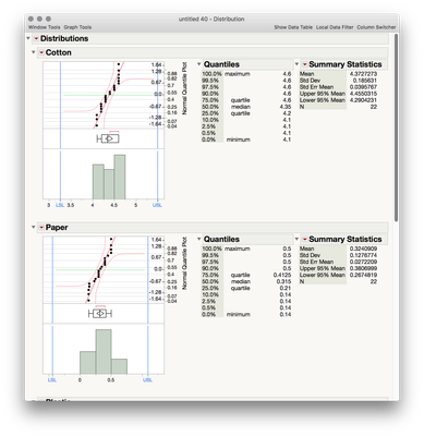

      I am not sure if I understand what you are trying to do. However, I will try and explain based on what I have understood .
      Shown below is my interpretation of what you are trying to do. Essentially plot a distribution of your data to be able to see the minimum of your type. I presume the graph shhown below achieves that.

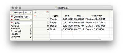

First guess: are you trying to construct a formula that will return a column with the type text, then an equals sign, then the value in the min column? The following formula in a formula column will accomplish that:
Concat(:Type," = ",Char(:Min))
and return a table like this:exampleTable.png
I've attached the example table in case it helps.
