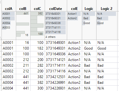

jthi
Re: Create Column with Values Based Off Existence of Other Rows & Logic
Logic in this script is overly complicated as I don't know all the limitations of the data (can there for example be multiple matches) and I didn't optimize it

dt << New Column("Group", Character, Nominal, << Set Each Value(char(:colA)||char(:colB)));
//fix date
Column(dt, "colDate") << Set Each Value(Substitute(:colDate, " AM", "")) << Data Type(Numeric);
dt << New Column("Logic", Character, Nominal, << Set Each Value(
	As Constant(
		m_group = :Group << get values;
		m_c = :colC << get values;
		m_date = :colDate << get values;
	If(:colE == "Action1",
		"N/A";
	, :colE == "Action2",
		cur_group_idx = Loc(m_group, :Group);
		If(N Items(cur_group_idx) == 0,
			"Bad"
			plus_idx = cur_group_idx[Loc(:colC - 82 == m_c[cur_group_idx])];
			If(N Items(plus_idx) == 0,
				"Bad"
				timediff_idx = Loc(Abs(m_date[plus_idx] - :colDate) <= 18);
				If(N Items(timediff_idx) > 0,
					If(:colE == "Action2" & :colE[timediff_idx[1]] == "Action1",
						"Good"
						"Bad"
					"Bad"
		"Bad";
