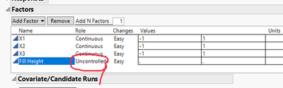

How about including Fill Height as an Uncontrolled factor? During your experiment, you'd simply record the level as it changes, and JMP would include it as part of the analysis. I've attached a sample DOE table.

thanks for your suggestion, we also thought about that but hoped that there would be an option that would allow to have the fill height factors settings in the model during setup to properly estimate power and fds.

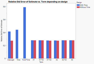

  1. The first option proposed by @Jed_Campbell works, but is not optimal regarding robustness of the design regarding time trend. You could have correlations between your time trend and your factors, and not be able to differentiate which of the two is responsible for the response(s).
  2. A second option would be to include time as covariate (and include both linear and quadratic effects) in the design : It is a special case of DoE with covariates ("time-trend robust designs") that you can find in "Optimal Designs of Experiments : A Case Study Approach" (chapter 9) by Peter GOOS and Bradley JONES.
Some key element from this chapter to answer your problematic of randomization with a run order factor :
"Using a systematic run order or systematic assignment to experimental units does not necessarily imply that there is no randomization at all".
There are already some litterature on this topic :
Making Experimental Designs Robust Against Time Trend : Paper5.pdf (ssca.org.in)
Experimental Designs Optimally Balanced for Trend on JSTOR
+ Joiner and Campbell (1976), Daniel and Wilcoxon (1966), ...

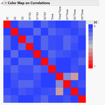

Here is an example with 3 continuous factor of a time trend-robust design, estimating main effects (X1, X2, X3 and time), 2-factors interactions (between X1, X2 and X3) and quadratic effect for time. You can see on the graph below that including time as a covariate doesn't inflate the standard deviation of estimates for main effects (X1, X2, X3) and 2-FI for these main effects (comparison of relative Std Error of Estimates with a design including time covariate and a design without time covariate), which means you won't lack precision for the estimation of these terms by including time as a covariate.
And you can also check that there are (almost) no aliasing/correlations between your time covariate and your other factors for main effects and interactions :
The design here is not completely trend-robust, but it is D-optimal with this time covariate constraint.
Hope this answer will help you,
