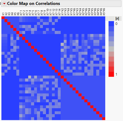

Concerning the possible correlation between main effects and interaction effects, I tried a D- and Alias-Optimal design for 5 continuous factors, 1 two-levels categorical factor, and 1 blocking effect (2 runs per block) with 30 runs (all interaction effects estimability set to "If Possible") and the correlation map shows no correlation between main effects and interaction effects :
There are still some minor correlations between block effects and main effects or block effects and interaction effects.
Note that in this situation, a design for main effects only would have required a minimum of 14 runs, and for main effects + interactions a minimum of 44 runs. Bayesian D-Optimal design enable to have this flexibility in run size, while conserving the possibility to detect interaction effects.
