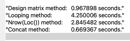

I know... but it is a surprisingly good method from a time standpoint. Interestingly the concat method, as odd as it is, is really fast as well.
For example, for a 200,000 row x 10 column table (compressed file attached) of these values, here are the runtimes:

print(evalinsert("Design matrix method: ^(t2-t1)/1e6^ seconds."));
print(evalinsert("Looping method: ^(t3-t2)/1e6^ seconds."));
print(evalinsert("Nrow(Loc()) method: ^(t4-t3)/1e6^ seconds."));
print(evalinsert("Concat method: ^(t5-t4)/1e6^ seconds."));
