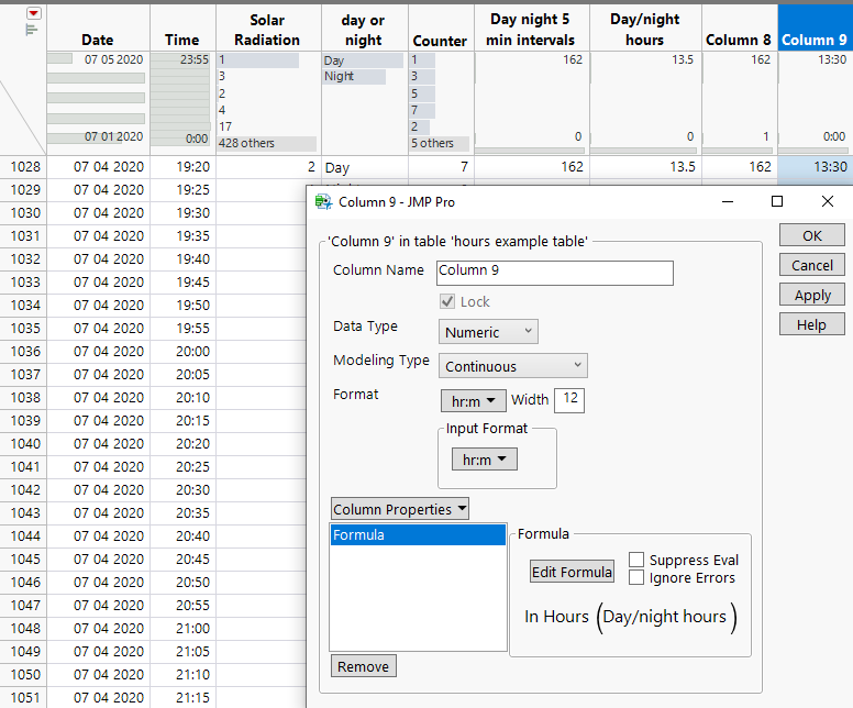

For the other question, I would most likely create new formula column with
In Hours(:"Day/night hours"n)
and then change the format (you could also multiply by 60*60 (In hours does this, it converts hours to seconds), JMP datetimes are in seconds so you want to convert your hours to seconds and let JMP handle the formatting from that)
You can also change the format to Best to see the "real" underlying value (seconds).
