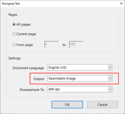

After much trial and error, I realized that the output setting (found in Scan & OCR -> Recognize Text -> Settings) had somehow changed to "Searchable Image (Exact)" either inadvertently by me or as the result of an update.
Changing this setting back to "Searchable Image" corrected this issue - no more cut off pages.
