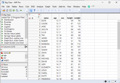

Start by selecting the sample.

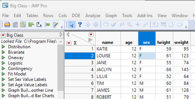

Row 2 is a Female with the Height of 61. So first click on the Sex cell for row 2.

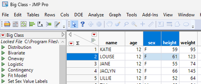

Next, the Height cell for the same row needs to be selected.  Since just clicking on the cell will clear the already selected Sex cell, one needs to hold the CNTL key down to indicate that the selection is to be added to the selected cells

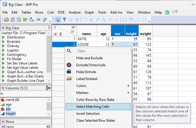

Finally, move the cursor to the RowState column and right click on row 2 and select, Select Matching Cells

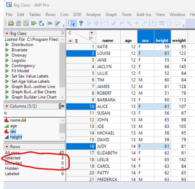

All of the rows that are matched will be selected and the total number of selected rows is specified in the Row Panel area of the display

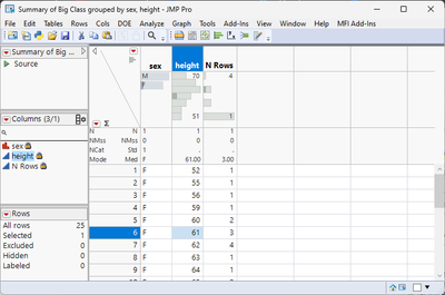

Other good option is to create summary table
-Jarmo
